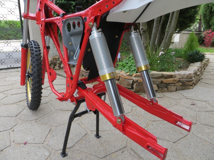

Amortisseurs  FANTIC RC FM260

@Chef1 I have a pair of Koni in good condition that I used on somebody else's 125 Brissoni a while ago. I might as well sell them one of these days since I won't do anything with them. They'd deserve respraying but they work perfectly well, not a single leak.

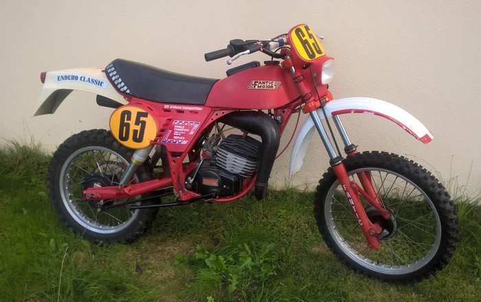

No, from a friend of mine.
The one i have gets Marzocchi GS680 (AG4) - This bike climbed brilliantly on the podium at the ISDT Revival
